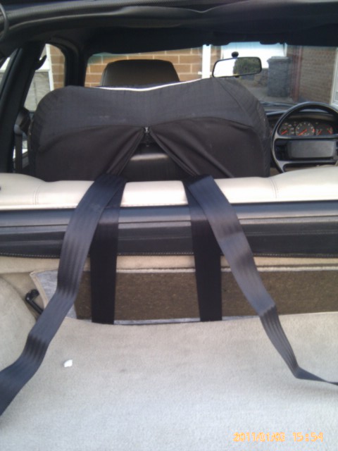

With the car seat belt alone I know what you mean, although this is actually pretty tight (after ALOT of asdjustment and refitting etc.). However, there are extra straps that come with mine which are designed to go through the frame of the seat in front when it is used rear facing. I've used these straps to go around the folding half of the seat. They prevent any forward rotation of the seat. So there are in total three straps (the car seat belt and two addtional) fixing the seat in place. It cannot rotate forward at all. I *think* it's pretty safe. Though obviously not as safe if it were rear facing.
I'll try to take some more pictures later of how it is fixed.

The view from the boot. The two extra straps wrap around the folding bit. I guess this is a weakness in the set up, as this does not hold the chair to the chassis. However it does completely stop the forward rotation which can occur using only the lap belt.

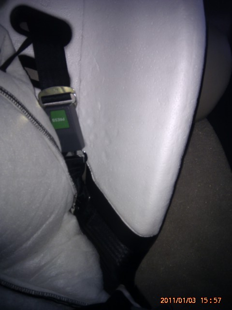

This is the view from the front, with the fabric pulled back from the polystyrene. The lap belt to the lower left loops through the frame and around the back of the seat. One of the extra belts can be seen here too, looping to the inside of the frame where it buckles, and out again.

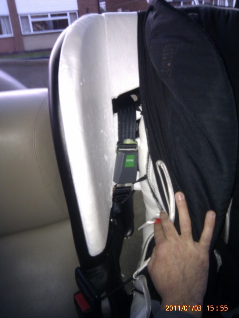

This is the other side of the seat showing again the lap belt and the third strap. It's hard to see in the photo that there are two different belts here - the lap belt and one of the straps that wraps around the 944's seat back.
The only way I can see of improving this set up at the moment is if the extra straps went round something attached to the chassis, instead of around the folding part of the seat. I noticed alot of foam on the floor immediately behind the seats. Anybody know what's beneath that?

Looking at your photo above and the way the extra straps loop round the back of the seat to prevent the forward rotation of the child seat I would have thought that this would be a better option than a 3-point belt setup. There were two main problems I had with my seat installation
1. the seatbelt buckle strap was too long meaning the actual buckle was too high up the side of the seat chassis, so as the belt came through the back of the seat it couldn't loop round the chassis meaning you couldn't tension the lap strap part of the 3-point belt against the seat chassis. This meant you had a good couple of inches of movement of the child seat chassis before it was restrained by the lap strap part of the 3-point belt.
2. as there is no depth of padding in the rear seat you can't compress the child seat into the rear seat so without the springiness of the seat pushing back against the tension of the seatbelt firmly fixing the child seat in place, the seatbelt tension couldn't be maintained and ended up being quite slack meaning the seat could rotate a good few inches forward before tensioning the seatbelt. In the event of a real crash this would mean the baby's face would probably impact the back of the front seat before the seatbelt actually did anything.
At least in your installation, even though you may not be able to firmly fix the child seat into the car seat, at least you can tension those rear belts preventing, or greatly limiting, the forward rotation of the child seat. I'd proably stick with what you've got rather than installing 3 point belts.
