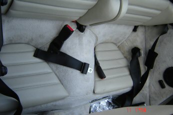

Hi Gary
You'll need to fit a 3 position seatbelt. This is what I got from QuickFit SBS.
I will try to find the picture they sent and scan it in, and take one myself of my installation.
I managed to fit it to existing bolts, and a hole for the top mount was already present.

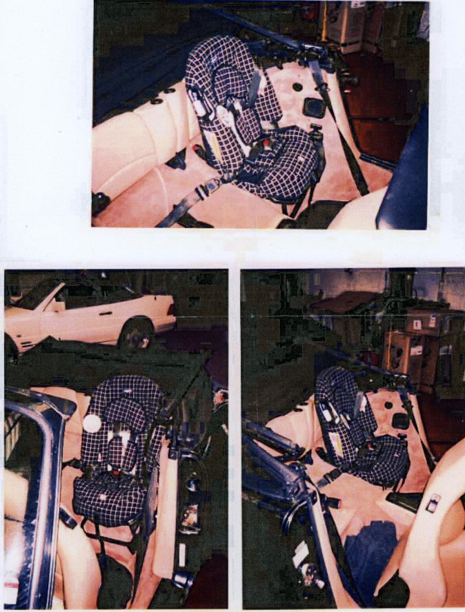

Hi
This is the picture/installation instructions from QuickFit sbs

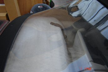

Here is a piccy I already had of the seat in the rear, although with blue ted in it, rather than my little boy. Will do a pic of it in the front with 3 point later.
