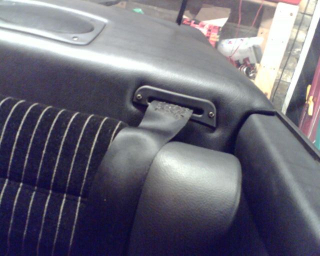

It twas I that helped J50 fit his rear belts. First you need to check you have a third mounting points on the rear shelf, I am pretty sure you will. This panel is joined to the upright below it and is removed by taking out the four phillips screws on the upright panel and then lifting it UP and out carefully as the speaker wires are still connected and there is a retaining clip, on the back of the upright, that needs to be cleared. I guess on your year of car that there will not be enough of a recess to neatly house an interia reel, so I would go for a fixed three point belt. The new belt will simply bolt into the three holes. I got my belts from quickfit, make sure you ask for a 'childrens' length belt, or else it will be difficult to make it fit tightly. The attached photo shows where you need to cut the holes to pass the belt through the rear shelf. I used a 993 cover plate a few years ago, J50 used a different one as mine was no longer available, it should only cost a few pounds. Hope that helps.
Sounds about right. I'll try and dig out the receipt with the parts numbers on for the plastic bit that surrounds the hole. As said by my mechanic above, there are two types of these plates, one for a 993, and one for pre-89. There is not much difference between them, apart from the one for 993 costs about £25 each and the older one costs £1.50... for a similar piece of cheap plastic!
