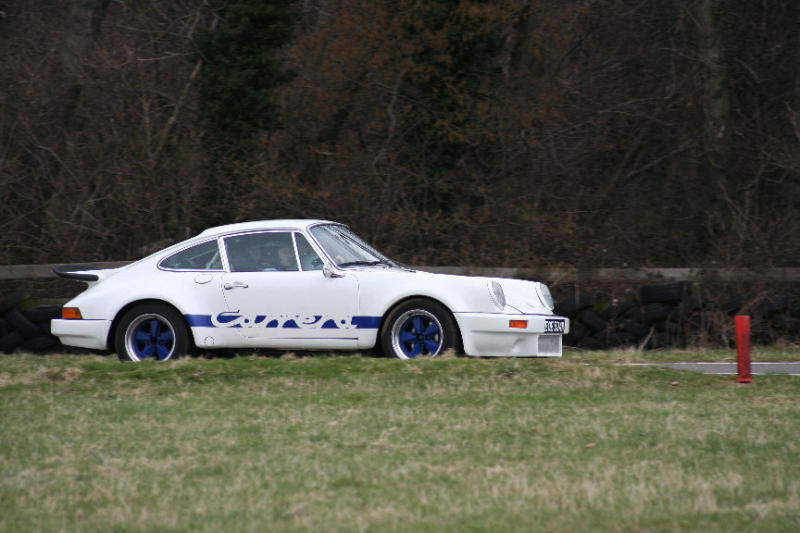

Hi, thanks for the pic,it looks a lot better than i envisaged trying to get a recliner seat in the back.I will give sbs a call,much happier that i hav'nt got to o any welding to the rear,thanks a lot,Hope catch up with u some time look out for my car
sorry for the late reply,no it was'nt this pic was of me at courbrough sprint this year invite of club audi,Brett
