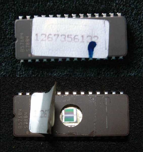

I finally got round to swapping out my chip for the Blitzchip this weekend. I've not had time to have a good drive out yet but it actually ticks over more evenly
One question though "" how do I tell if the chip in my ECU was standard?
Here's a pic of it for all you experts out there.
You can't tell by looking at it, and stickers can be changed.
The only way is to read the contents and compare with the original chips. From there you can workout the changes (map, baseline settings, rev limit etc.) if you have the correct information or a specific DME programming software module.

I appreciate what you're saying Rick, I just meant does it look like the standard chip expected in this ECU.
I don't suppose it really matters anyway [8D] I was just curious if the car was standard prior to me getting it

Not quite sure, Andy, but I seem to remember mine having 944 part number on the sticker ...
