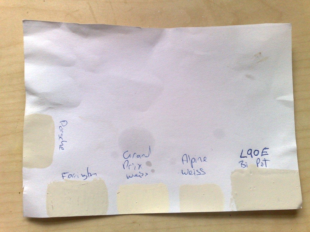

They are not! Mine is the same colour as yours and has had a top end respray at some point in its life - the bonnet, light covers and roof have all been resprayed, you can see its slightly different in colour. Ive paint mixed by 4 different places now and have 4 slightly different shades of white, its hard to tell just looking at it but as soon it dries on the car you can tell its slightly off. I put them all on a bit of paper that i can hold up to the paint to see how well it matches each section, not sure if its worked though :p The colours are very different when seen side by side, Grand Prix white is much whiter, whereas Alpine is "dirtier" or tinged yellowish.
