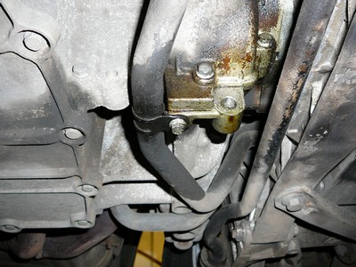

This is a photo David (DRDT) was having problems attaching.
Looks like a classic RMS weep to me David.
To add some text to photo. Taken last week whilst car was on ramps having fronts brakes sorted. Not sure the week/seep is any worse than before and certainly there are no drips on my garage floor. OPC at the 911 clinic recently suggested monitoring as it was not bad enough to warrant the expense of attending to. Makes a nice change for a garage not to suggest work needed.
I have the same problem, been like it for three years I am hopeful for it to stay like it until the clutch needs doing, and it can all be done in one hit.
Me too - oil staining on vehicle but no worse than 2 years ago and no drips on floor.
Common occurrence then?
