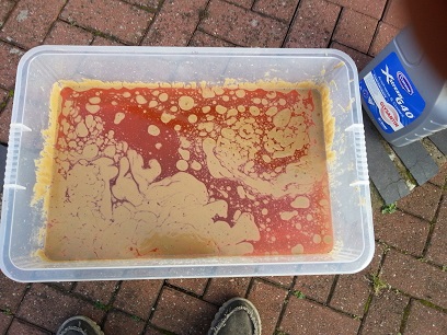

I presume by Oil Pressure being higher than water pressure this would explain why ive OIL in the water. Not Water in the Oil. ?
Have flushed the water again after getting this much out after dropping the water from the engine (Note WAter VERY clean)
Am making sure the oil is EXACTLY on level and will test it again. Expecting Emulsified oil as I didn't do a properflush

I've seen pictures of a header tank with less oil in it than that after a D-chunk failure.

ORIGINAL: Rodney Naghar
That is a fair amount of oil.
