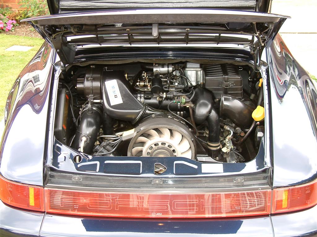

Pic attached was a very dirty engine when i first got it [;)]

If you want to protect your engine Tectyl is the product you need , it provides a heat proof wax coating, see my pics below.
