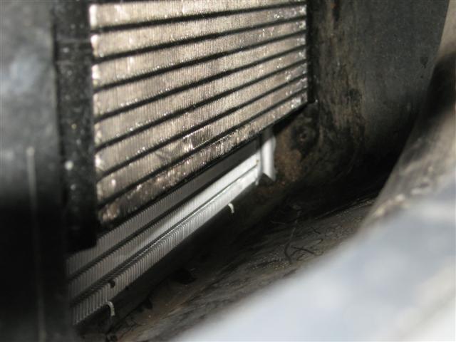

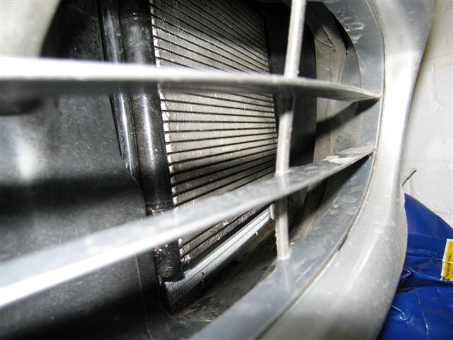

ive had new rads and condensors fitted, you can see in the pics where the rubbish sits by the damp marks in the pics in the corners
these pics are with the new rads fitted
