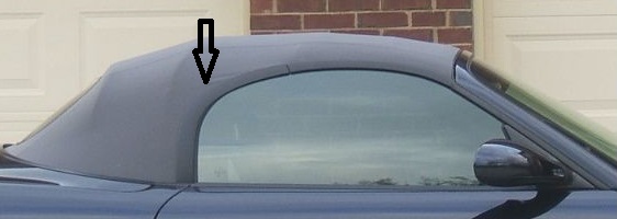

Whenever I close my roof, I notice that on the passenger side, part of the fabric seems to hang outside the two hard plastic connecting tabs that join the roof to the window. For a while I didn't actually notice this problem, however I did experience greater difficulty in clipping the handle at the top of the windscreen when doing the final step of closing the roof.
In any case, the problem with the fabric falling outside can be corrected by re-opening the roof and manually pushing the fabric in.
I just went to take a picture of the problem - and lo and behold, it worked totally fine when I opened and closed the roof (that feeling when you are having a problem with your computer, call tech support and it suddenly works fine)! In any case, attached is a photo (of a generic Boxster rather than mine) of where the problem occurs if the description is unclear.
Maybe the problem has now gone away and is temperature related (?), but any tips on how I can fix this without having to manually push the fabric in every time I close the roof?

The velcro strap seems fine. I'm not sure where the metal tensioner is or whether this is the problem. Have taken another photo of the side where the problem happens. Any suggestions?

Not sure if my solution has already been suggested - but I took it to my dad (!) who cleverly fixed it - and thought I'd show as some of the earlier instructions posted, while very helpful, looked quite complicated to a simple guy like me.
First, open the roof half way.
Second, there is a straw-like plastic tube, which I guess is about 2mm in diameter, identified by the red circle. This is attached to the fabric and should be flush in its plastic frame. In the case of mine, on the driver's side, it was flush and there was no problem. On the passenger's side it was hanging loose - this is what the embedded photo shows, although it isn't easy to see.
You have to push the plastic tube, together with the material, so it is flush in the plastic frame. It's really fiddly to get in the grooves and you have to be very careful that you do not damage the roof etc, but this fixed it for me!
Alternatively, if you have a smart dad like mine, maybe he can do it for you!
FYI - here is how the thin plastic tubing on the driver's side, sitting nice and flush, looks (my message I posted immediately before this showed the loose plastic tube). Use this the good side of your car to figure out how the problem side should look.
