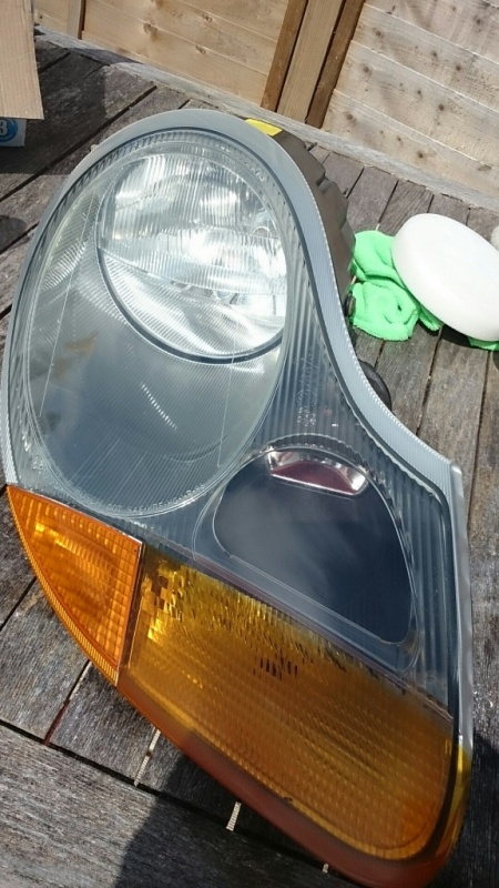

New member First Post, This was on my Project list for this year so i thought i would dive in with how i did mine on the 986.
The old girls headlights were showing their age, i bought a Meguiers headlight restoration kit last yearwhich helped but i still wasnt happy with the results. It didnt do enough to remove the tradmark 986 yellow ridge.

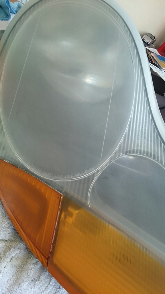

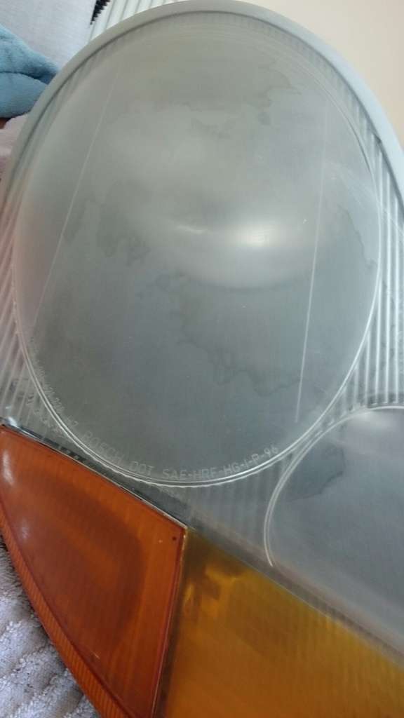

So i decided to go full hit and attack them with wet and dry (600,800,1200,2000),AG correction compounds, Rotary 1500 rpm and AG super resin polish @ 2000 rpm.
In the end i am really pleased with the results and worth the effort. Thanks must go out to the 986 designers as removing the lights is of course super easy and makes the process a lot easyer.

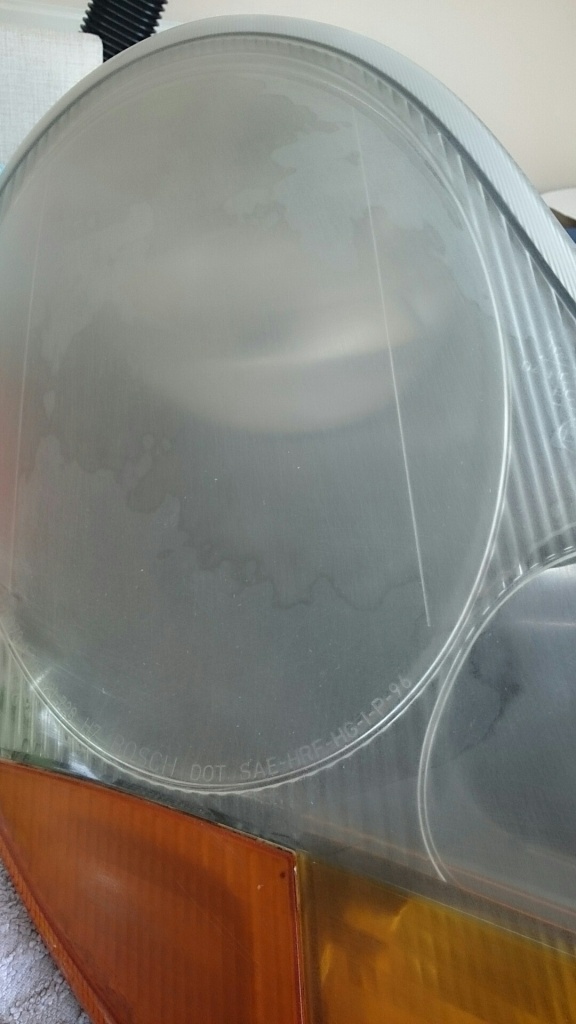

After the 600, 800 was used to repair the Damage done by the 600. I would not recommend using the 600 unless your lights are as pitted and scratched as mine were.

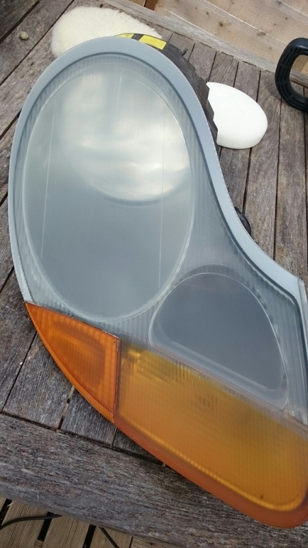

Final Pass with Rotary as detailed above. Realy pleased with the results. While i was messing about took the rubber of and cleaned with AG rubber and vinyl care.
