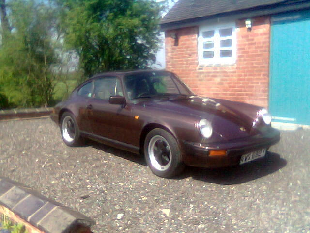

Any suggestions as to how much a 1982 sc with 100k and good history is worth? There is a bit of rust on the rear arches just above the bumper and at the bottom of the A pillars - in both cases it hasnt got any worse over the two years I've had it. Other than that, it's been a lovely thing to own. It's metalic brown with half-leather and half chequer pattern - very 1980s [;)]
Good to hear you can keep driving. Unless you can find a buyer who doesn't realise the implications of rust on the A-pillars and elsewhere you are looking at a sub 9-9.5k price.
TBH, I wouldn't be too upset if it went for about £9k, it's a really pucker car but not a total minter; a car to be driven and used rather than just polished and displayed.
I gather that the A pillar repairs are a bit drastic [:(]?
