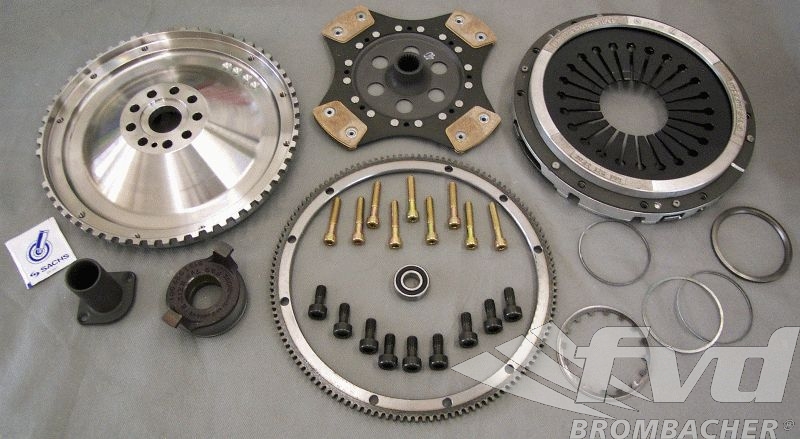

Anyone recommend a good Porsche specialist for clutch kit upgrades?
I may need a new clutch to handle 800Nm shortly if I decide to go ahead with my Cargraphic Powerkit for my 997 Turbo.
Wondering if this would be a good solution?
http://www.fvd.de/shop/?VID=931183&VCD=81622619&AM=1&SM=1&LM=2&MM=item&AC=item_details&item=FVD1169092
Sport clutch kit 993TT/996TT/GT2/997TT with light flywheel 870Nm (sinter rigid disc) 1.495 €
Kit contains the following part: Pressure plate, rigid sintered disc, release bearing, Flywheel,starter ring gear, guide tube, bolts.
Been informed that a rigid sintered disc would be a nightmare for the public roads. Need an organic plate.
just fitted rs fly wheel to my 993 tt with 508bhp and it good on the road no noise or vibration what so ever, and on the track it is diffrent class [8|]
My 930 is a different animal altogether, but I did fit a 5 puck clutch plate for a while. Boy did it grip, but a nightmare to live with on the road. After 1000 miles I replaced it with a "hybrid" which comprises of an organic face and a Kevlar face (from Clutchnet in the US) . This offers the same grip with the uprated pressure plate, but at least you can now pull away at something less than 3000 rpm to avoid judder.
