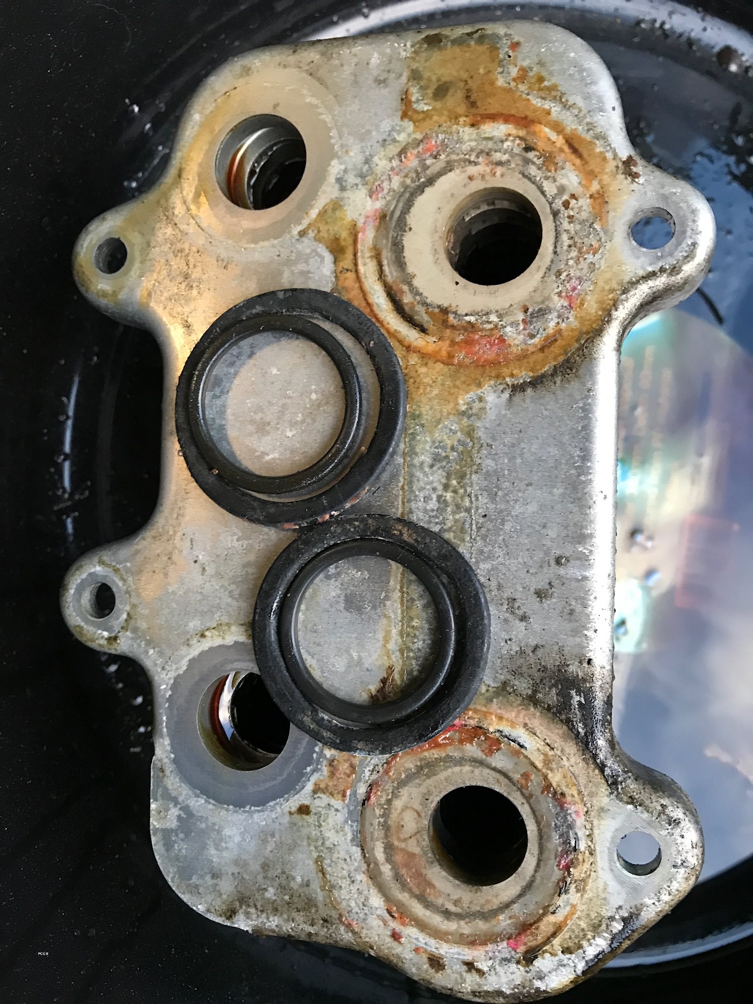

this evenings task, dropped a cup full of oil from the sump, looks clear and uncontaminated. Then to remove the oil cooler, access was much easier than expected. 35 mins from lifting the lid to removing the cooler. 4nr 5mm Allen bolts.Oil side of the unit is nice and clean, waterside presented with quite a bit of surface scale with some evidence of leakage and very hard and brittle washers. So new set of washers and cooler due on Wednesday. Fingers crossed.
