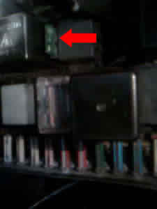

Turns out theres a 2nd fuse 'hidden' between the relays for the cold air blower. I replaced the fuse and the cold air blower is working again! Lucky eh, i thought i was cursed as the heating system has also died on my renault espace (which they quoted me £800 to replace), why dont these things happen in summer? [:D]
Anyone have any ideas as to why the fuse is of the 'new style' (square with 2 prongs) type rather then the old bullet type fuse? I'm just guessing, but back in '82 we didnt have the square type fuses, did we? Seems strange that Porsche would of mixed and matched the 2 different fuse types. I was gonna upload a pic to show you, but my mobile phone battery died!

I found the fuse between the relays (under the passenger glovebox, above the row of bullet fuses).
Give me an hour or so and i will upload a photo for you, so you can see what i mean...
Here is the pic... (i have highlighted the fuse with the red arrow)

Closer inspection shows that the fuse is 'plugged into' the actual relay (which explains why its a 'square type' fuse and not a bullet one. [8D])
Its rated at 30 (which it also says on the relay).
