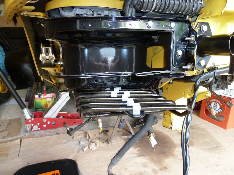

just been rethinking this from memory, isn't/shouldn't it be on the nearside coming from the bonnet catch direction, the release handle in the car is on that side. I think mine was on the nearside.
i think you guys are right - i just put it back where it was when i took the stuff off - looking at the photos again it makes more sense to have it the other way
if thats's correct Jake, which I think it is, yours would have had to pull round a 180 degree corner, maybe somebody has had the PU off in a previous life and not known what the cable was and just 'tucked' it away across the front.
