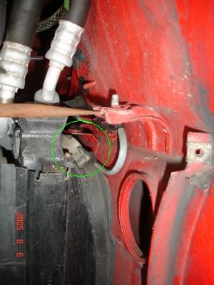

Testing the condenser ballast resistor is a bit more tricky. It's worth doing a swap of the relays (the condenser, oil cooler and rear blower all use identical relays which can be swapped around to prove a point). However, the most common cause of the cycling condenser fan is, as I said before, a corroded ballast resistor. The only real way to check it is to remove the nearside front wheel arch liner and take the thing out. It's attached to the top of the condenser (a ceramic disc about an inch and a bit in diameter). Unfortunately there is a battery vent pipe close to where it's mounted and it does it's best to corrode the ceramic.

yes replaced mine last year after your help, managed in a badly lit garage working mostly by feel, much easier when i found out the round resistor is attatched by an allen head not the 8mm spanner i was trying to use doh!
handy article and photos on rennlist diy site too
Changed the ballast resistor at the weekend and problem solved. The old resistor was falling apart!!
Very difficult to get to though - needed a mirror on a pair of forceps to see how it was attachde to the condensor!!

just been in garage and you are correct as the resistor had crumbled to pieces. You are also more than correct about it being a PITA to get at!!
Unfortunately the retaining screw absolutely refuses to budge so I think I will have to secure some other way.
