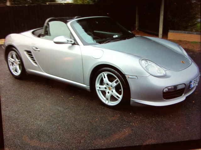

Notice that you are after a 2008 2.7 Boxster I am just about to put mine up for sale as friend selling his 993 and I am keen to purchase.
It's a 2008 2.7 sport with 38,000 miles ,full Porsche or Independent service,last done just over 1000 miles ago.
It's silver with full black leather,6 speed,18 inch perfect alloys ,heated seats,windshield,Pasm and cruise control.Also has twin pipes and Sport Diffuser at rear.,with booster s badging.
Oh and has 6 months tax,8 months mot and a Rac platinum warranty for remaining 8 months .Its a second car so cherished , looking for £15,600 .If interested let me know Alex
