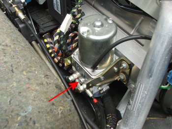

someone suggested checking the hydraulic fluid in the convertible to pump? where is that located , how can I access it?
Michael
I would check the fluid level first. The pump is behind the panel behind the rear seats. It has a clear plastic reservoir on the bottom with min and max marks. I'll post a picture when I get to my PC tomorrow.
