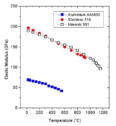

Trawling the net, I found this graph (no, not from an SS supplier!) which would suggest that 316 Stainless steel is not a million miles from the performance of a Nimonic alloy, but obviously a lot easier to get hold of. The possible difference is at the higher temperature range.
The best I could come up with for temperature was a sparkplug range of typically 400-900 C. How does this compare with turbo exit temperatures?
Regards,
