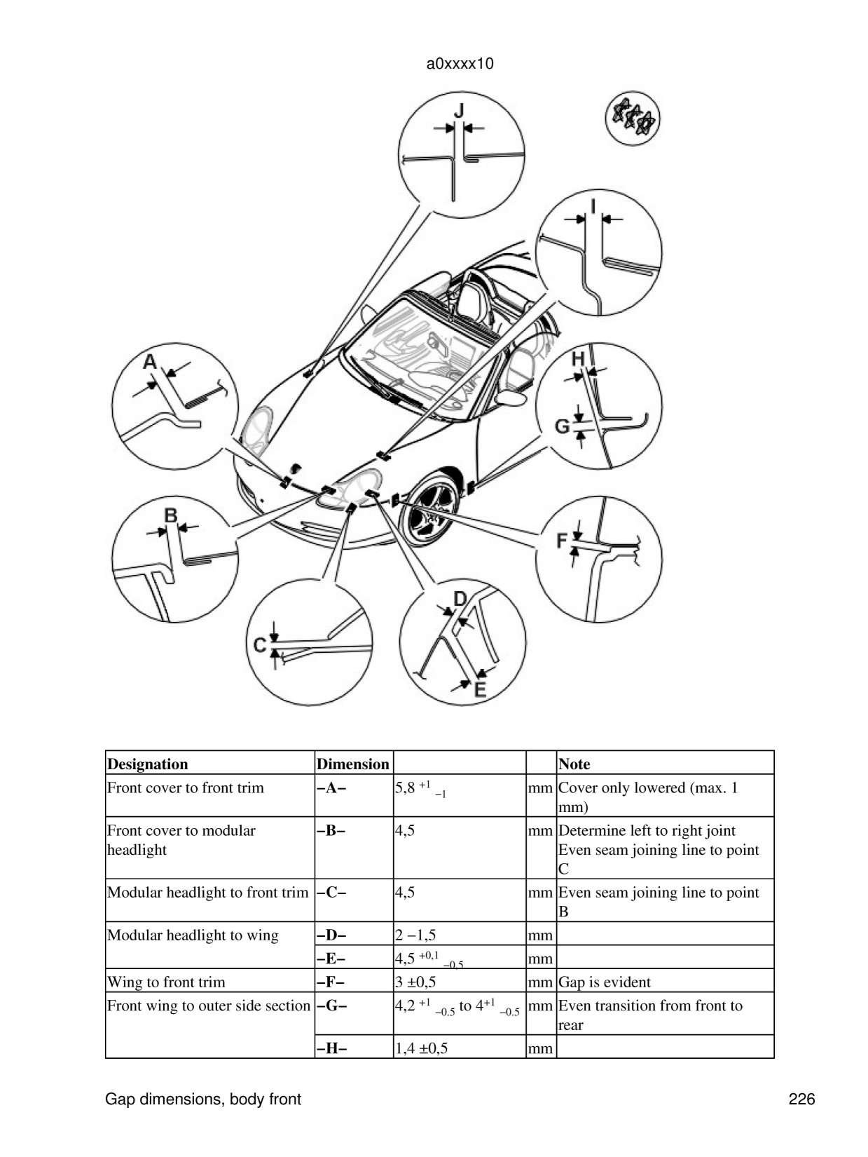

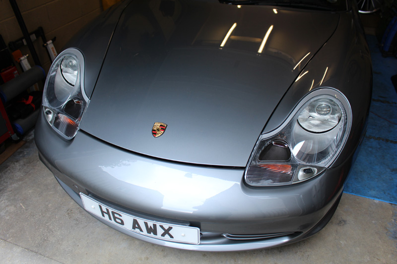

Is anyone able to tell me the correct spacing between the front bumper and the front edge of the bonnet? I think the gap on mine looks too wide. If it is, can it be adjusted easily?
I have included a photo.
Bonnet to bumper and wings looks a little big, maybe look at the bolts on the bonnet hinges and see if they look like they have been undone.
