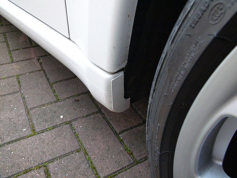

Had exactly this on my 2009 Boxster.
The leading edge of the sill is constantly grit blasted.
I repaied mine 3 years ago just as you have, but used white Smoothrite and topped that off with Porsche white touch up.
However, from white thin abs sheet made a guard that faced the grit and adhered it to the sill leading face with tenacious (Gorilla) double sided tape.
That on both sides has worked wonders.
Both been on there for about 18k miles and all the car washes too.
Thanks for replies & very good pic.
My mission is to copy the stick on protection, maybe increase height to cover the gap between sill & wheel arch.
