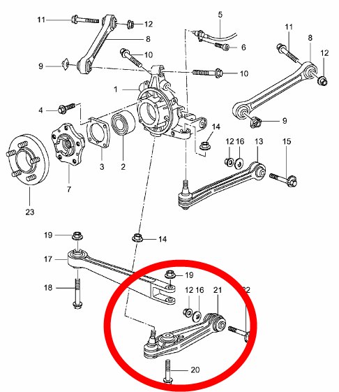

Drop links are straight forward if not a little bit of a struggle to get at. Get the TRW ones as the material for the boots seems a lot better quality than other makes. I fitted a pair of front coffin boxes made by Hamberg, the king pin rubber boots were shot within a couple of months, very disappointing and a little expensive.

When you say coffin boxes I'm guessing you mean as part of the wheel assembly. I had trw ones fitted on all 4 as the old ones where knackered. Trw actually make the originals then grind the Porsche badge off so I'm guessing they might make other 'proper' parts.

Coffin boxes = 'the bit in the red circle'
