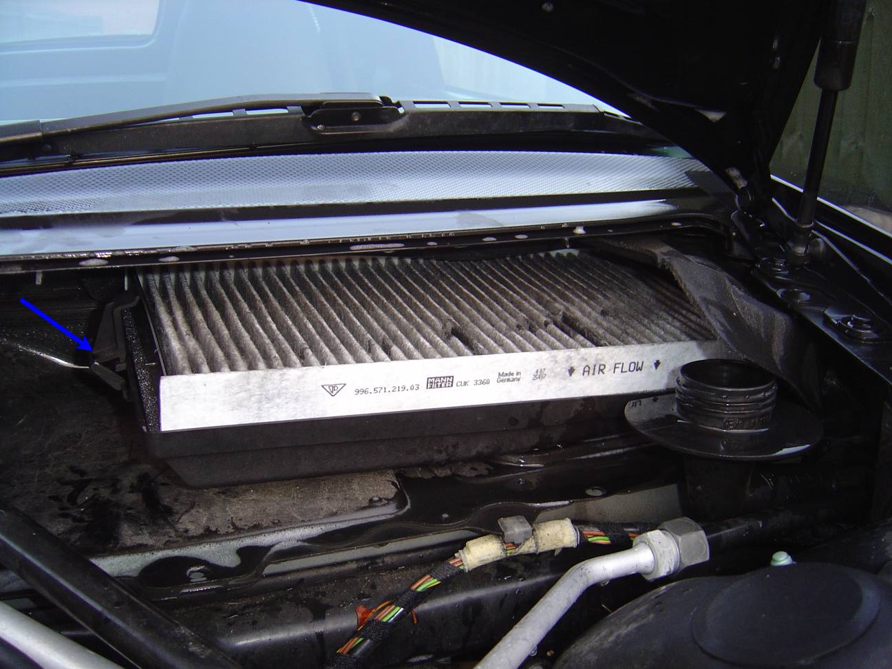

Funny this topic should come up, today I removed the plastic cover around the washer bottle filler due to a leak, the leak was easy to fix but revealed something interesting.
In the attached 'photo you can see the pollen filter as I found it, exposed with what I assume is the cover missing due to the clip arrowed in the picture flailing around.
Now have a look at the pollen filter itself, dirty eh? Odd considering the car had a 48K service just 2K ago, oh, and look at the water that has been absorbed into the filter itself, no wonder I have been getting misted windows.
Before I lambaste the offending garage I just want to check with the forums members that there is indeed a cover for the pollen filter, if not why are there clips?

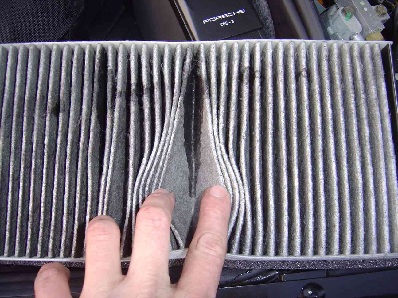

Second photo in following post

There are 2 types of filters. The standard paper and the activated charcoal. The part number that ends in 03 is the more expensive charcoal filter. If the part number ends in 01 then it is the cheaper paper type. The price increase may be because you had paper and now charcoal?
On a LHD car there is no cover for the filter. Never seen a RHD but our filter looks just like the above picture.
Is the charcoal held in a separate section under the main filter or is the filter impregnated?
I am just thinking that maybe the reason for the dirty look of my filter is in fact because it is charcoal.
So the filter just sits there? No cover to protect it from water ingress or hold it in place? Seems a bit slapdash??
It is impregnated. And it does look 'dirty' even when new. You can verify what you have by looking at the part number, but I can see from your picture you have the charcoal filter.
Just checked my own pics, the filter P/N ends in 3 but it does not look much like the one in your pic. The charcoal layer is rather more sparse!
