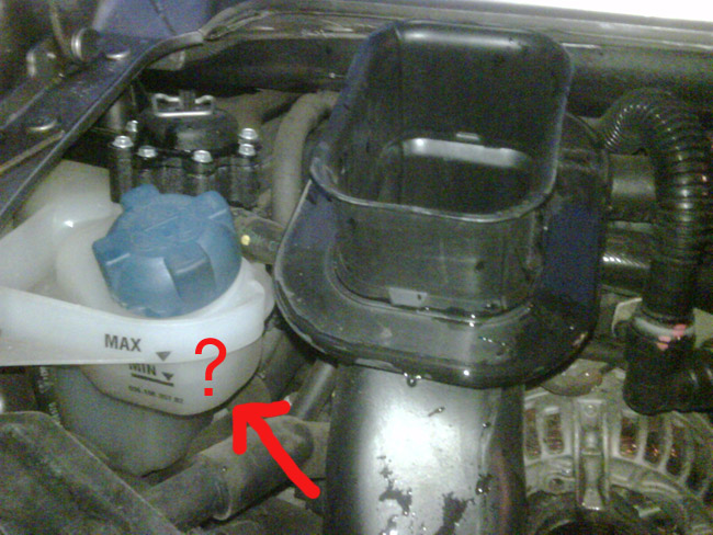

Could somebody identify this please - C4S
jonc4s
Appreciate somebody confirming what this reservoir is for?
Yes its the 'header' tank for the coolant system - one of the common failure items on the 996 (as well as its cap).
I can vouch for that.... sometimes misdiagnosed as :
"...the engine has slipped a liner..." (i.e. rebuild) or
"the cylinder head gasket has gone... (i.e. could have caused a lot of damage)".
And that was from an OPC!
My car needed a new header tank cap. Much cheaper than either of the above diagnoses!
Thanks Guys, well mine is slightly below minimum so best get some coolant in there!!
Any recommendations of a particular product that will work well?
Thanks - Jon
