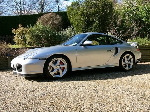

Congratulations Uppy, what spec did you end up with(apart from TT) and where the pics[;)]
glad you are enjoying it.
garyw
it's an 03 TT with a few options Sat Nav, Heated Seats, Telephone Module coloured crest's on the wheels, leather steering wheel but I think thats standard, Aluminium Handbreak and Gear Lever and Porsche Mats [:)] Black Leather Interior and Artic Silver on the outside.

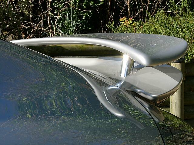

I see you have found the spoilers posing button for the photo's [;)]

Very observant and here is a picture of it extended the pistons shine up really nicely.

I don't think my hydraulic struts were that shiny when it was new!
