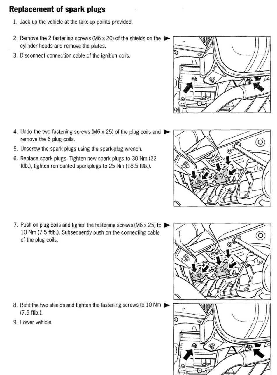

Are they fairly easy to fit?

Here you go:
