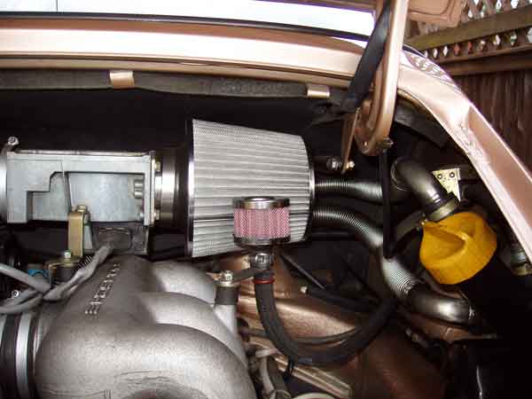

Did my filter last year, the pipe in question is the breather pipe from the charcoal fillter off the fuel tank,
I put a small filter on the end see picture, I got this off ebay for a few £
The other pipes if the ones you are looking at are about 30mm dia, one runs from the top of the engine and the other one from the back of the air rubber intake both to the oil tank.
Thay take fumes/gasses from the engine and tank, I made some SS pipes up at the same time as I did the air filter as you can see
I would not leave them off you will get oil on the engine
Thanks for the advice guys, Graham I like the look of the SS pipes you fitted and the extra filter is good way to tidy up that pipe I left off. I dont have easy acess to a SS welder so will probably continue looking on line for some rubber ones. By the way four engine bay looks great hope you didnt go to the trouble of cleaning it up just to post me the pic.!!![:D]
Ray
