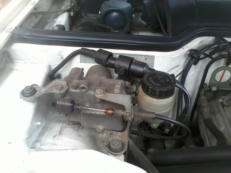

I didn't realise that my '86 944 was fitted with a cruise control unit in the engine bay, until now that is.

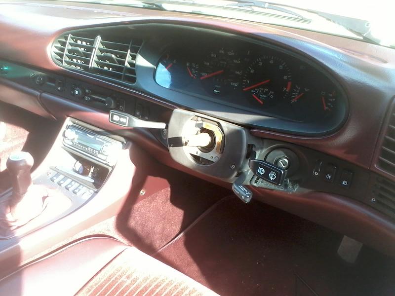

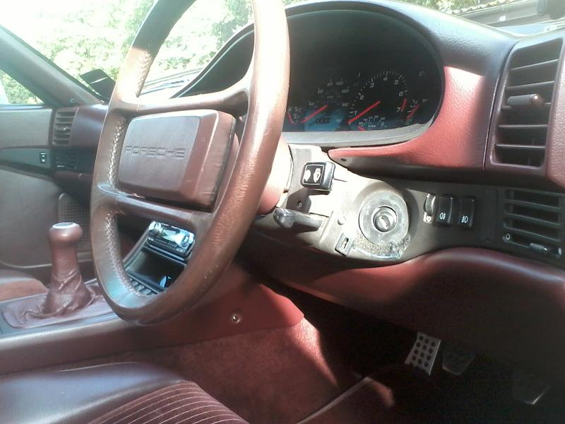

Only trouble is the steering column mounted stalk/lever is missing! just a hole remains where it should be.
My question is would I need to buy a complete indicator/wiper/cruise control unit that fits onto the steering column?.......or can the cruise control stalk be brought and fitted on it's own?

Looking at the PET (Porsche parts manual)- it appears that the cruise control is part of the switch (signals, high beam, etc) and is all one piece so unlikely that a stalk is available seperately.
Definitely a complete module rather than individual stalks. Probably about £30 from the states. Check under the glove box for a silver box mounted above the bonnet release with 2 large black connectors; this is the ECU for the cc system and will also be needed to make the system work.
The stalk module is really easy to fit though.

Yes, I am aware of the box of tricks above the hood release button.

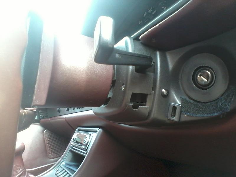

Update on this thread...........
I eventually found a cruise control / indicator & wiper control unit for under £100. [:)]
Just finished fitting it. Had to pop over to a local Halfords to get a 24mm socket so that I could get the steering wheel off.
Anyway job done. Just got to test it out now. I'll be looking for a nice quiet dual carriageway to try it out. Hope the box of electric trickery works ok that's in the near-side footwell. Guess I'll soon find out. [;)]
