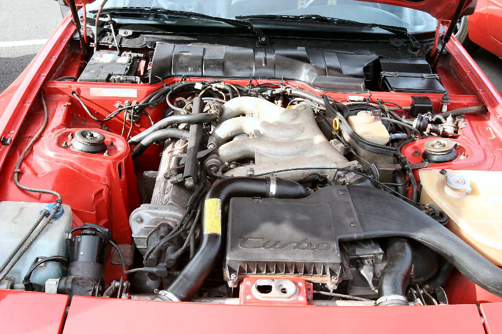

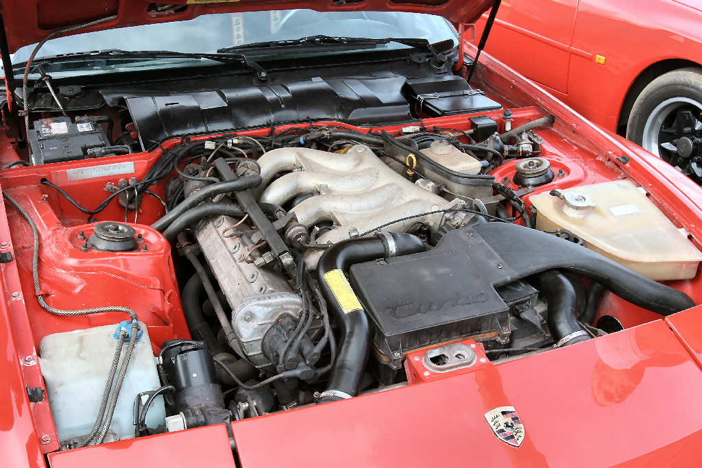

Here's the pictures from the Silverstone Classic. Fen & I examined it at the time.
The inlet manifold looks bog standard 220. The injectors and FPR are standard. We couldn't see the Turbo because of the standard airbox / j-Pipe / plumbing.
The engine does nothing to indicate it is anything other than a standard 220/250 spec from the outside.
