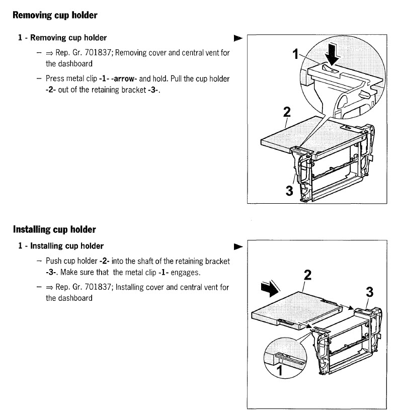

I need to replace the dashboard cup holder assembly. Can someone please let me know how I can remove and replace it? It is a 2003 C4 with two cup design?

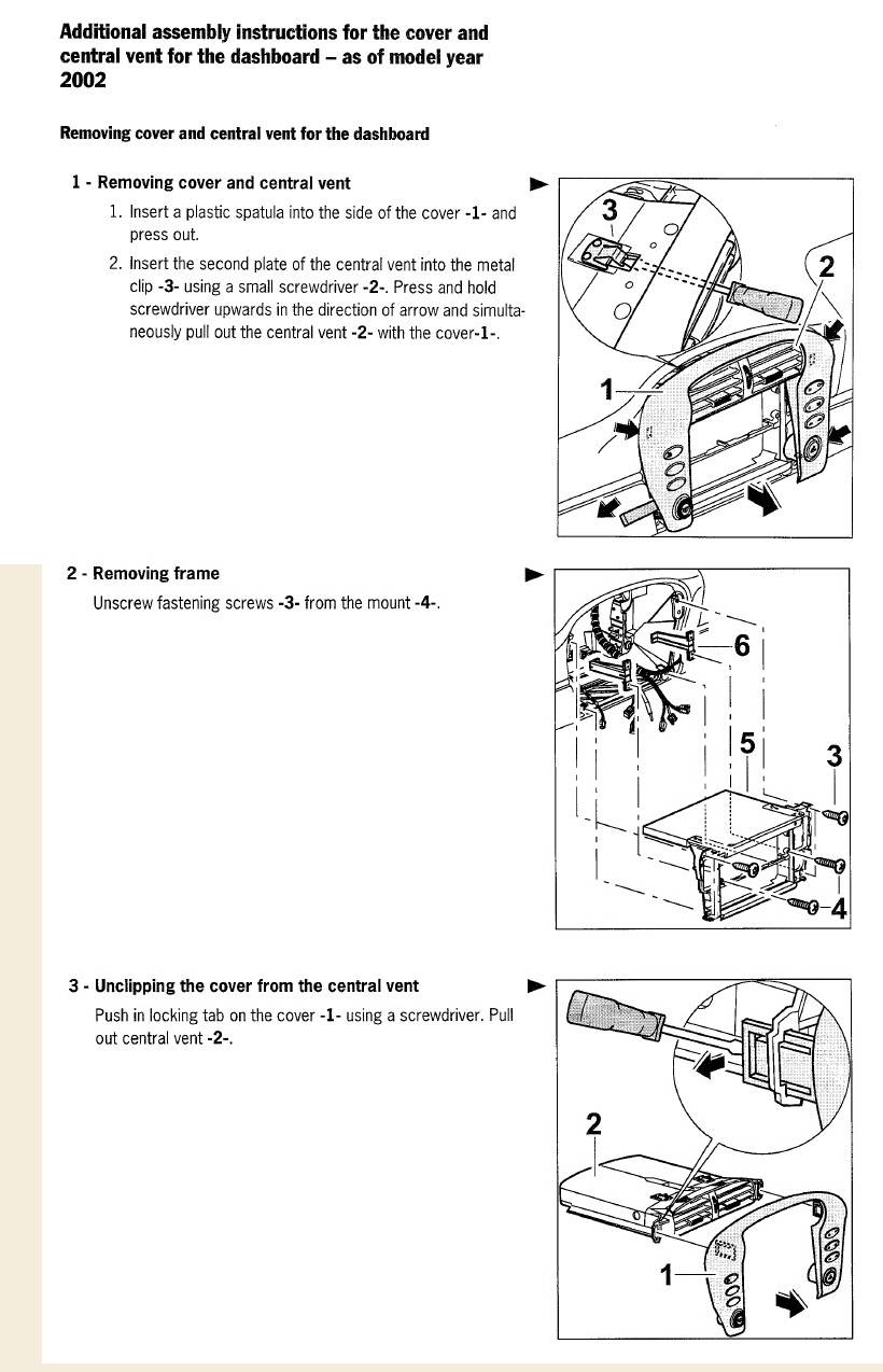

Central Vent removal:

My local dealer has one in stock so thought to see how it is fitted first.
Looks nice and simple.
