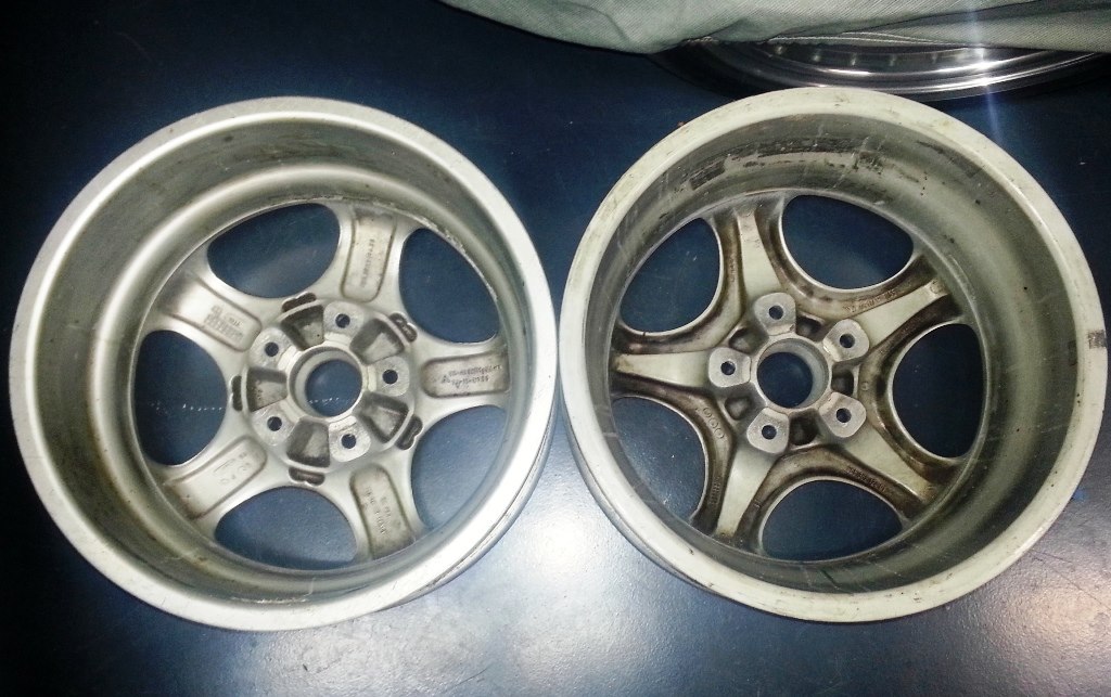

I wait to be shot down here but won't the difference in number signify near side and offside? I.e. They are a set with 00 being one side of the car and 01 being the other?
Mick
The face is identical but spoke backs are different .01 spokes are thicker in design and also weigh more. Which may be an issue.
Interesting one mld... not seen that one before. From what I see in the PET catalogue I thought 00 and 01 denote opposite sides of the car and are often marked as such - L/H or R/H (catalogue not in front of me so can't say which is which)...
spoke backs are different for 00 vs 01.
front wheels weigh the same.
rear wheels 0.5kg difference between the two on my bathroom scales..............
The last 2 digits denote a change/modification, whether it be some small detail, manufacturer or manufacturing process. From memory and as mld has pointed out, I also recall the back of the spokes looking different also the inner rim edge having a lip and the other not. Not sure which was which will have to check mine.
More info and theories can be found in this Rennlist thread
00 left / .01 right in picture
Link to wheel weights
http://www.944racing.de/wheelweights.php
It would appear there is a 600gram diference between the two rears, 01 being heavier than 00.
Fronts are same weight and so should be no problem with a mix..................

OP, you have a mixed set, but the fact that the main Part Number has not changed means they are interchangeable. (the .xx characters are variants of the Original design which occurred during the component life span. Its the only way to manage the component variants.)
If the wheel spec was not interchangeable, a new Part number would be issued.
