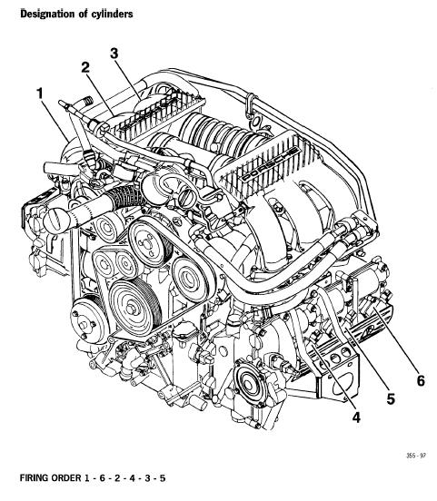

cylinder layout diagramme for 911 c2 3.4 l
leamus_123
hi guys got my car pluged in its missing on cylinders 4 5 6 has any one got a cylinder diagrame or lay ou so i dont make more work for my self cheers[:)]
Here you go:
