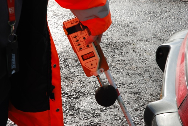

This is my father in Law's C4 with D-cat and G-pipe... probably a bit loud for some trackdays!
This is 105.5dB @4000RPM

As Greg points out, two alterations to the exhaust tend to get you to or over 105 db (static test). Personally I think that's a nice noise and as long as you have a normal interior (i.e. not stripped back to the metal) it's not intrusive on long journeys. You might annoy a few neighbours if you start it up early in the mornings and you will have problems getting on track days unless you buy a silencer tip to put on (which are quite expensive). From what I've seen and heard the order of noise tends to go like this:
Cat, standard, standard = quietest (about 98 db)
Decat, standard, standard
Cat, cup pipe, standard
Cat, standard, G pipe
Decat, cup pipe, standard (about 105 db)
Cat, cup pipe, G pipe
Decat, standard, G pipe
Decat, cup pipe, G pipe = loudest (makes your ears bleed)
The first four combinations will get you on most tracks. The others are borderline or no chance!
