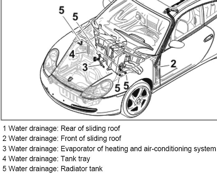

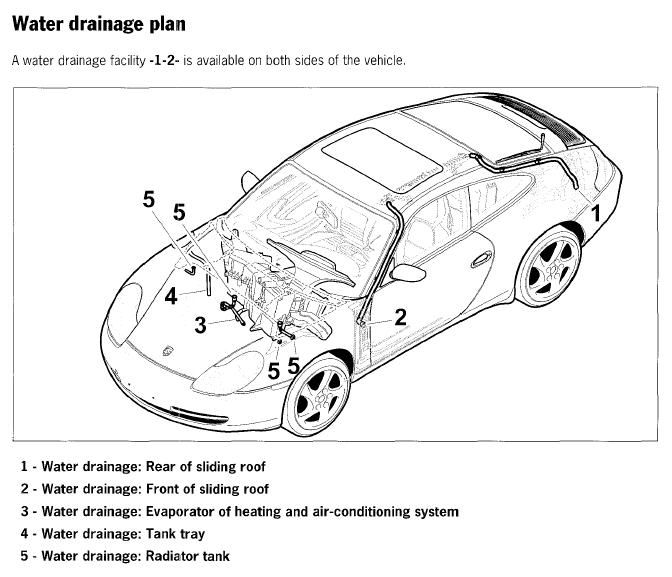

The problem is most likely the roof drains are blocked. Or it might be a door membrane or blocked door drainage holes.
Thanks Richard...i will look into again in a few days. Not sure at the moment where these things are even with the diagram, but with a little more time im sure i will find. I took the car out just a minute ago and carpet is feeling even wetter. Its not raining so i dont understand. Lets hope it is blocked drains somewhere as im not aware of any water lines in the vicinity.
For the roof drains there are rubber nozzles at the bottom of the tubes. The front ones are in the door shuts, and the rear ones are in the rear wheel arches. The book says to close the sunshine roof, and carefully blow an airline in the nozzles. Then open the roof and vacuum out the debris.

Are you sure it isn't coming from the front compartment? The water drains around the front cowl area (where the battery is located) often get blocked, and the water spills into the front of the passenger compartment.

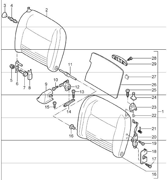

2. How do you remove the rear seats....ive removed the end bolts but cant understand how the middle section comes apart
many thanks
It isn't shown in the manual, but I would think that you slide off the cover (9) and undo bolt (10).

I was getting a small amount of water in front driver footwell. Didn't notice it at first but that damp smell helped me notice.
On investigation, both of the front drains (to the left and right of battery) were badly blocked. Cleared them out and now water drains away nicely.
To test the roof drains, I opened sunroof and gently poured some water down the front and rear at the side. I was running out of time but could hear some water drip from the two rear arches but not as freely as I would have expected.
Similar at front so I expect some clearing will be needed so I am going to investigate tomorrow evening.

1) Maybe it is my old eyes, but I can't even see the rear roof drains at the top. If it was me, I would try to find where the drain tube exits at the rear, and put an airline on it at that end. Be gentle though. Failing that, I would take off the C pillar trims and inverstigate.
2) If the rear drains are blocked, it tends to drip down inside by the rear seats and into the rear footwells.
3) On the front roof drain, you can just see the drain hole in the corner. It exits in the door shut, through a grommet just below the top hinge. Give it a gentle blow with an air gun, or use nylon strimmer cable to poke down the hole from the top.
