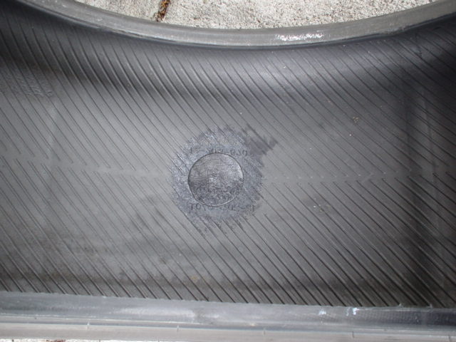

I have had flats repaired with my first and second set of tires when they were relatively new. For some reason it was the left rear both times. Drove on both sets until they wore out.
When I had the third set put on I took a look inside the old tire to see how the repair held up. Looked the same as the day the repair was made. The shop I use knows what they are doing, and even puts on an annual Porsche tech session.
