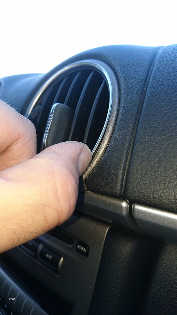

1. Remove the silver trim using thumb nail. Just so it doesn't get damaged as a bit of force needed to get the trim tools in.

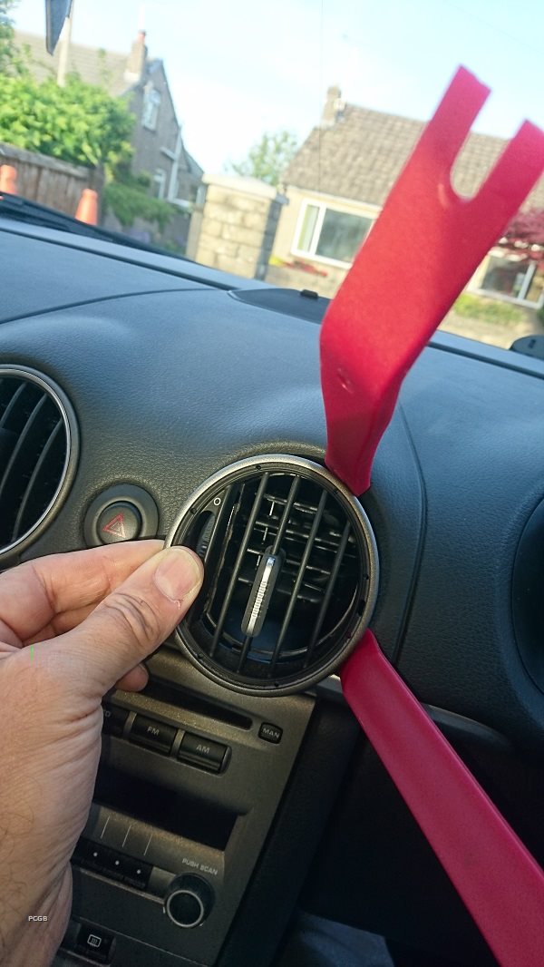

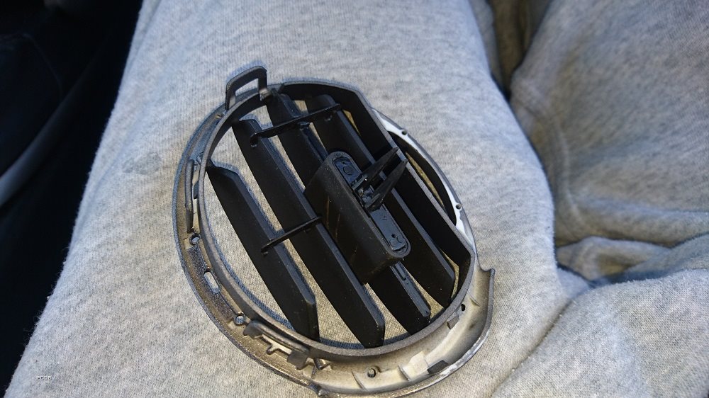

2. Using Plastic trim piece removal tools push between the dash and the plastic vent. Opposite side to the thumb wheel in 3 places.

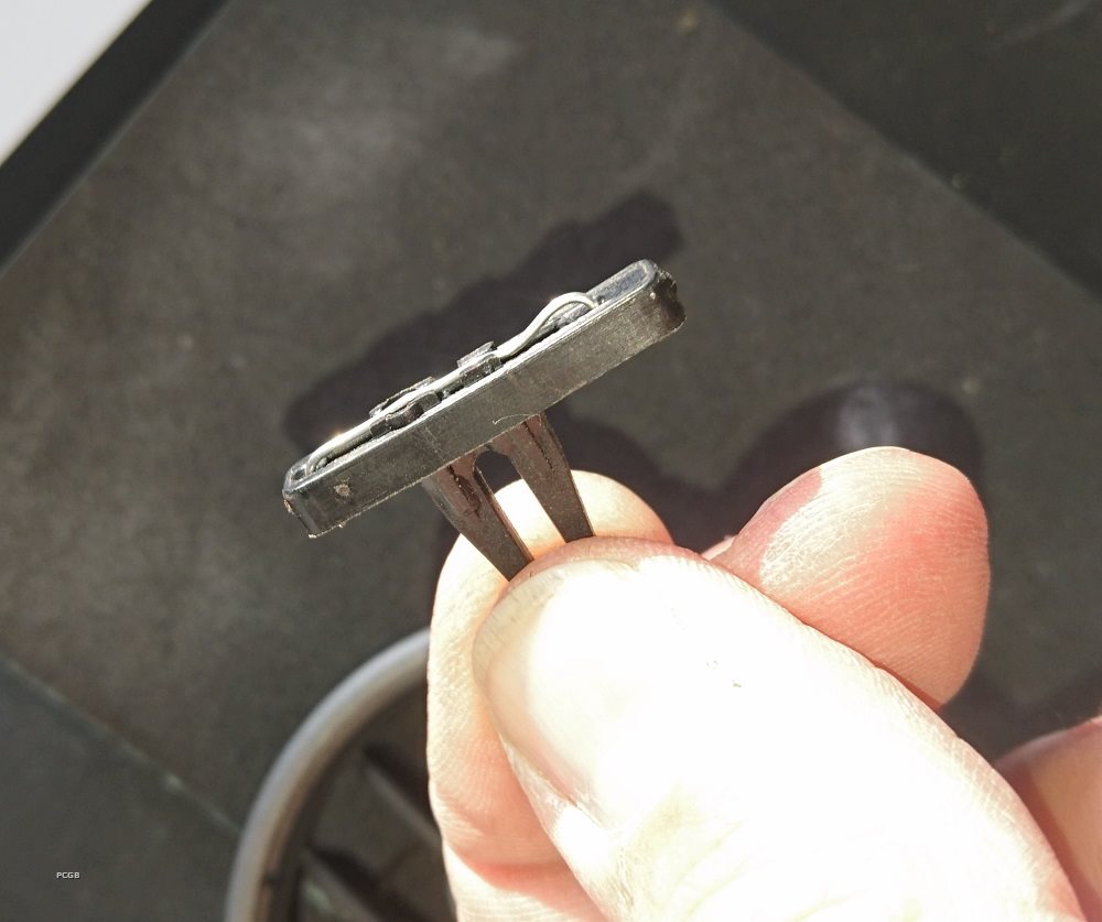

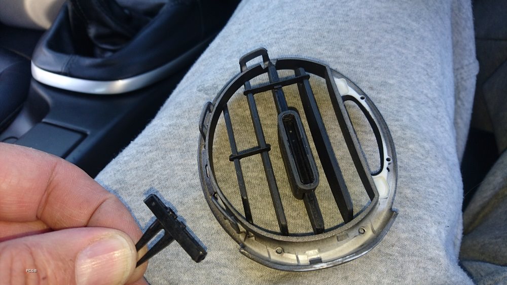

3. The fork piece pushes in the back of the slider. Will only go in one way, there is a small notch on its side.
4. I lost the metal clip spring some how!! Looked everywhere so I made one from stainless locking wire.
5. Superglued it in so it wouldn't come out again!

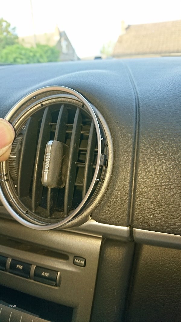

6. Press the grill and slider assembly back into the vent ensuring the fork locates over the centre vane with the middle part missing.
7. click the trim ring back...jobs a good un!
