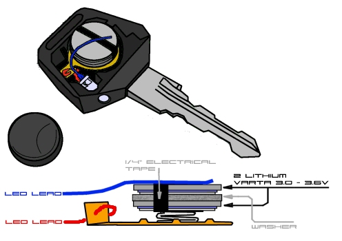

ORIGINAL: some clever chap on rennlist
Ohh, I JUST made my own yesterday! I got SICK and tired of trying to find a working battery & bulb combo, so I tried copying Czar's idea!
check it out:
1 $2 Ultra-Brite blue LED (3.9V)
2 $3 Varta 3.6v batteries in series!
1 washer (to bring the 2 batteries to the same thickness as the 1.5V Varta.
and a little bit of solder!
Plus, the process is completely reversible!
I'm happy to say the thing is as bright as a high powered flashlight! It's a bit overkill, but damn it cool!
