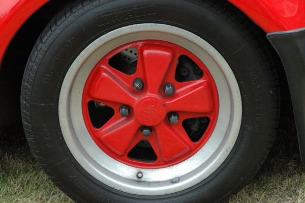

From the attached pic of the front brakes on our old SSE you can eaily see the big turbo brakes, and the rears are noticibly even more different to a standard 3.2.
