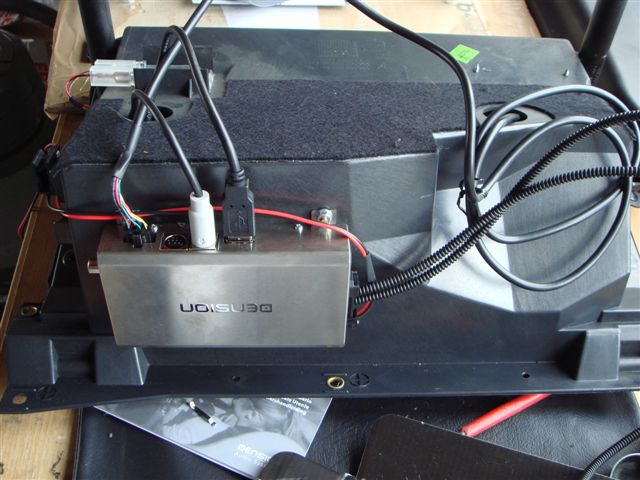

Richard Hamilton kindly sent me some detailed instructions for fitting into a 2003 Boxster with a CDR23 which I used to fit the Gateway 500 into my 2003 TT also with CDR23 - it contains the details for programming with the PST which were helpful for the brief trip to the Indie and will be very similar with the PCM. PM me with your email address if you want them sending on.
I installed the unit on the back of the glovebox as space was a bit tight elsewhere.

I have been pondering on where best to site the equipment and so far my thoughts are for putting the Gateway unit in the space vacated by the CDC which means I had to order the cable extension kit. What I haven't settled on is the position of the USB mounting kit, Aux input and the Ipod Clip. Strongly feel they will end up in the glove box but nothing is set in stone yet. As anyone (and I am leaning toward Richard Hamilton here!) got a picture/instructions of the Glove Box removal?
David, when you need to update the firmware, how easy is it to get to your Gateway when its in the position you have it? And if you are refering to the Radarack website download for a Gateway install on the Boxster I have already got that thank you.

Those are the same instructions and as you have the CDC yours should be plug and play once you set the jumpers. I don't need to access the unit as the USB cable is also in the glovebox and I have already used it to update the firmware. I also thought about the CDC location but everything was neater under the dash.
I have the glovebox removal instructions also from Richard so I will email these across to you now.

As for the positioning, yours does look very neat and out the way and I realised soon after asking about updating that the USB lead will do that. Are you pleased with the results with the system and can you select and browes the Ipod in much the same way as you would out of the car?
RB
Ron - I have the CDR23 so functionality is not as good as the PCM. However you can use the iPod itself (or a passenger can) or you just use playlists to move around. Not had a problem with it yet.
The quality is great and obviously much more capacity than a CDC.
