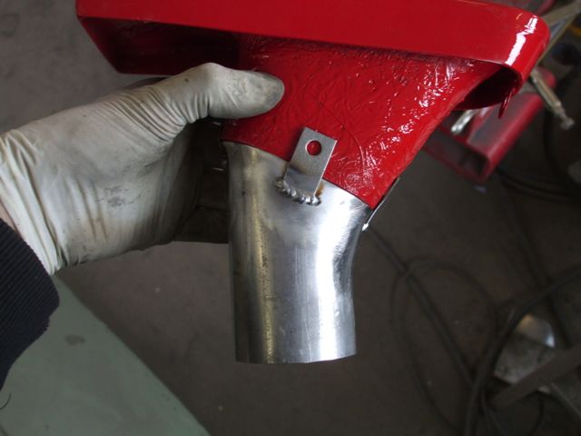

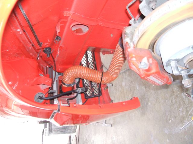

Actually found the standard brakes are much better for track use than perhaps one might expect. Sportwagen made up some funnels to channel the air from the front brake ducts in to hosing which then feeds directly on to the brakes. This does make a significant difference.

I'll post up a pic of the funnels that Sportwagen made up for ducting the air flow as they really do the trick. Not sure if you can buy these in plastic any longer but I believe the ducts that fit in to the bumper are no longer available OEM. Certainly the RSR has the funnel on the back side of the duct with the heavy duty articulated tubing to direct the flow.

Have the same ducting on the RS actually, and I agree its very effective. However, I'm heavy on brakes in all cars. Some people just are!

...but some years ago (and after some ruined brakes in Clubsport events) I changed my style and learned how to be more effective with the brakes.
Both, as Ben said above, helps.
Temperaturewise the front is safe (Big reds and vented), if ever a problem might occur (hasn´t eversince) it will be the rear brakes. The PORSCHE lettering on the calipers looks a bit cooked.
