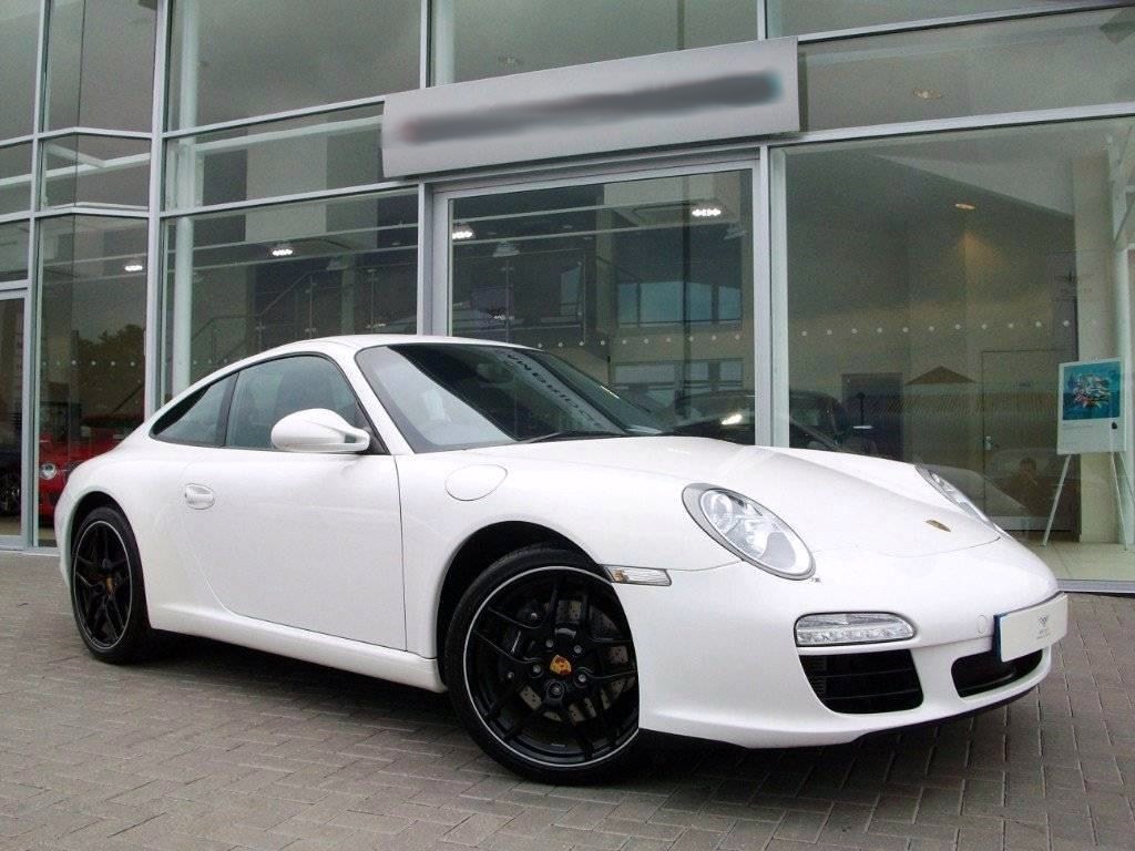

Hi Jamie,
Looks like we have virtually identical cars.
Mine is the 997 Gen2 manual, 3.6 with 17k miles, in white but black wheels...and I get exactly the same as you from cold.
Slight hesitation, seems to run lean (or rich), don't know, but never considered it to be a problem, just the car warming up.
Runs perfectly after a few hundred yards and quite happy with it to do that. Never try to rev it above 2.5/3k till its warmed up in anycase though.
