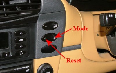

.. so presumably there's a wire somewhere that can be earthed or taken to 12v to toggle through the options, Richard.
maybe this could be wired up to a spare switch on the dash, to save the fitting of an extra stalk?
That's what I did on my C2 before I fitted cruise and a 4 lever stalk. I used a footwell lighting switch:

Fuel range on remaining fuel is handy to have though. If you fancy retrofitting the switch (costs about £35 in parts) to make it functional, drop me an email and I'll send you the wiring details.
