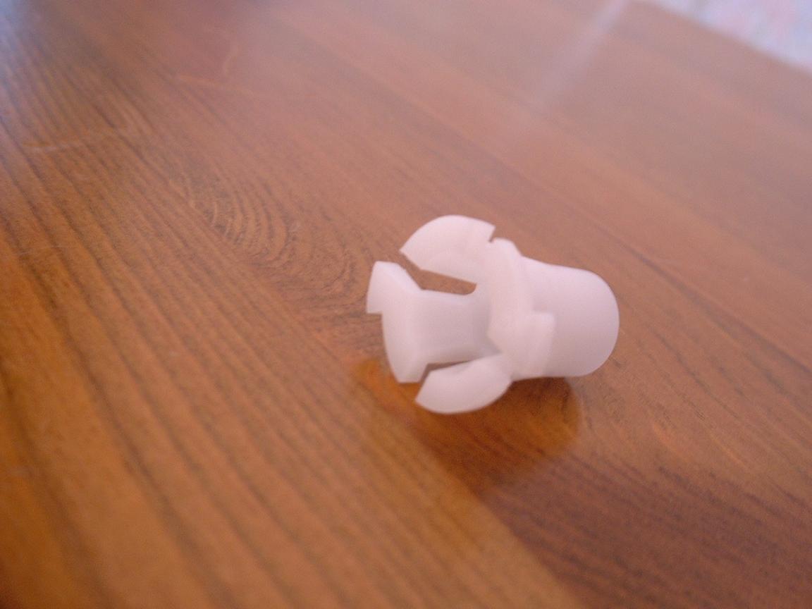

New headlights are £57+VAT. I got one for £47 this week because I had a hole in one of mine and my MoT has nearly run out. Also buy the adjusters at the same time (3 per side , 41p each). I didn't and now have to pick some up tomorrow because they are made of 'breakolite' and shatter when you take the old lense out.

Whats the part number Fen? [:D] 41p sounds very reasonable
Is this what you are after?
If so the p/n is: 944.631.912.00 and they indeed cost 41 Earth pence each.
Hmmm I was after the screw that turns in that bracket, but was told the whole lamp bracket was one part. Now that I've seen you can get those brackets seperate, maybe the screws are obtainable as well. I'll take that pic and the part number into the OPC so I can look at their parts diagrams
