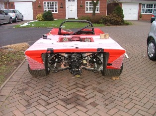

Can anyone please measure their front wing mounted oil cooler radiator for me?
I want to use one in my hillclimb 911 engined Lola, and can buy a new cooler for just £359, but I need to know the height, width and thickness to see if it will fit in the space I have.
