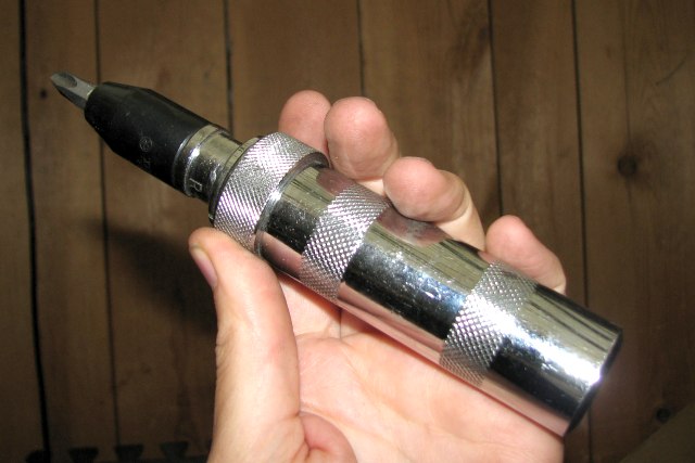

I can't view the article, but always remember to use an impact hammer on the retaining screws for the disk so you don't chew them up.
From my own experience, I've never had an impact hammer or impact screw driver chew up a screw / bolt, it's normally not applying enough direct pressure / incorrect fitment and turning without applying enough pressure that chews up screws / bolts.
I use one like the below for discs:
Impact screwdriver
Fantastic bit of kit. Put it on, whack it with a mallet and it always cracks them loose. Using one of these has saved me a lot of times. I think of it like this, if you try screwing a wood screw into some wood, and you don't apply enough pressure but instead put lots of force into turning, the screwdriver will rip chunks out of the screw head. Put your weight behined it and then turn and it won't chew up the screw.
