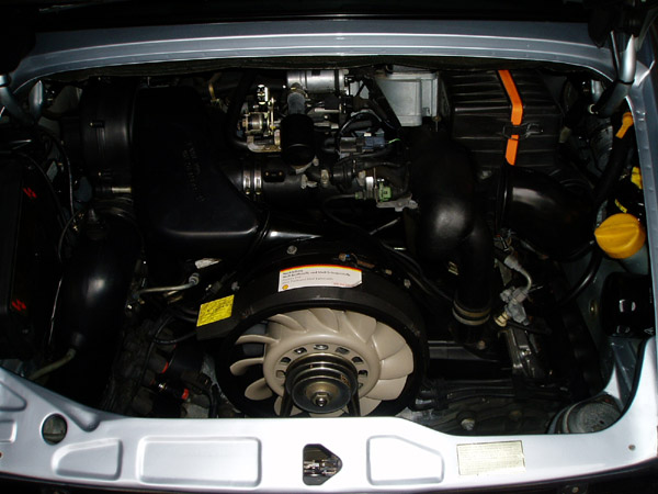

I agree it is a bit of a shocker. I'd like to see a pic of your engine bay as I've not seen one without the kit fitted.
Steve, as requested here is a pic. Not sure why you ask to see the engine bay! However seeing that you are interested here it is. The kit arrived in the post today and by the time you read this it will be fitted. Hope you like the picture.
Paul
Thanks Paul, it was just to satisfy my curiosity. I'm now jealous of how clean your engine bay is[:-]. To return the favour here's a photo of mine with the vent kit fitted. Sorry it is very poor quality and was taken just before I bought the car - it's a lot cleaner now!

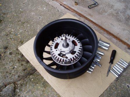

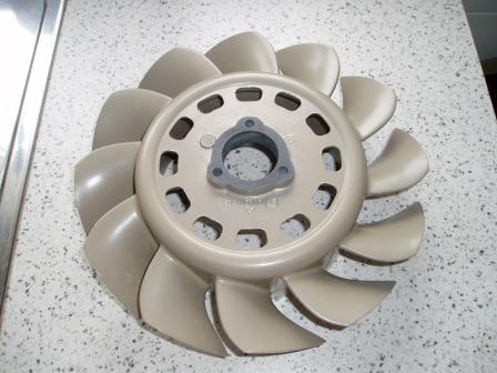

Thanks Steve, no need to be jealous, you own a 964! and a Boxster for your daily drive hey ........ a bit of a clean is no sweat. What suprised me really, from my point of view and from the service record and file of bills it was obviously the car that had been looked after. So you would have thought such an important item like the vent kit would have been fitted. Until i had joined the forum and spoken to various people it was not something i was aware of. The alternator cooling fan is so clean because i replaced the alternator recently, so took the oppotunity to give the fan a proper clean a refurb' the aluminium housing the alternator sits in.
Here are a couple of pics .... oops apparenlty you can only upload one pic per message!
Paul
