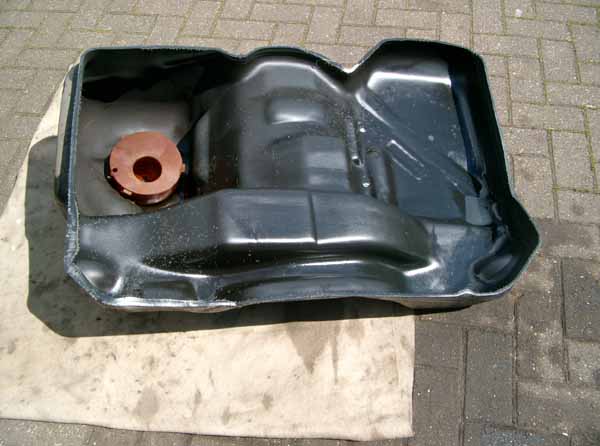

Here are some pictures of the fuel tank in my 968.
I had to change it because of an ineffective 'swell pot' that caused fuel starvation leading to fuel pump failure -- this happened on trackdays, not in normal road driving.

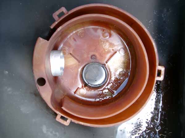

picture 2, top of tank cut off using a DIY jig-saw, showing the orange nylon swell pot in the bottom.

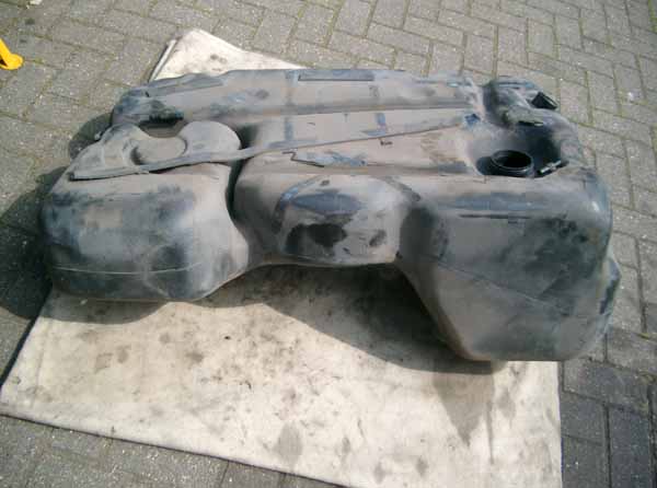

picture 3, top of swell pot has a large hole for the fuel sender which is not in the shot. The lid of the pot is held with 3 clips and these fail to secure it properly and it is prone to lifting off, then the car exhibits fuel surge when cornered fast.

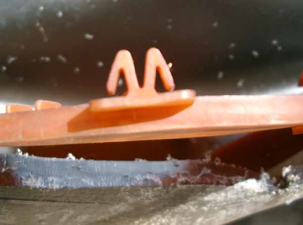

picture 4, top view of the swell pot showing the 3 clip fixing positions, the entry ways that the fuel gets into the pot, the ally bit at the bottom is the outlet hole on to the fuel pump.

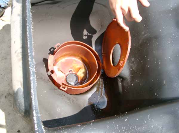

picture 5, close up of the clip that secures the lid of the swell pot to its body, this clip hardens with age and loses its shape a bit. As a consequence it is likely that the lid will lift off.
