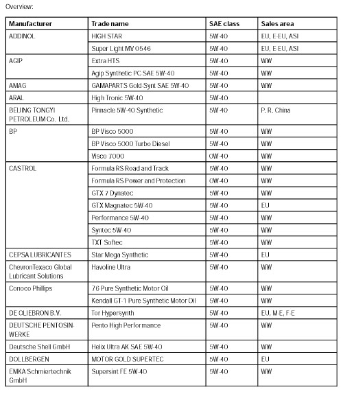

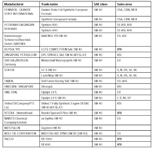

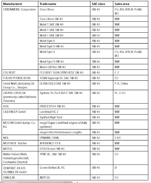

Well a very good and knowledgeable indy told me that some of the RMS issues are not helped by the very thin nature of Mobil 1 (0W40).
I consulted the Porsche approved oils list and found that the Fuchs Titan Supersyn oil is 5W-40 - not much of a change granted, but higher viscosities like 15W50 do not feature on the list. Used Titan Supersyn on previous cars and found it excellent oil, never discolouring like some of the Castrol lubes did, and a bit cheaper than Mobil 1 too - £27 for 4 litres delivered from Opie
